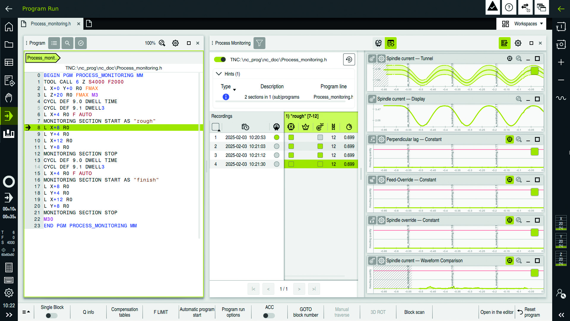

RELIABLE PROCESS MONITORING
With software version 21, the existing process monitoring capabilities of the TNC7 are being enhanced with an intelligent recommendation system. The system automatically suggests appropriate monitoring settings and incorporates additional data from the simulation environment. In this way, it helps users identify tool and
process deviations at an early stage. The recorded process data can be visualized directly on the 3D tool path, allowing loads, material removal, and potential deviations to be identified at a glance. As a result, process monitoring becomes not only more powerful, but also easier to understand and significantly simpler to use.
