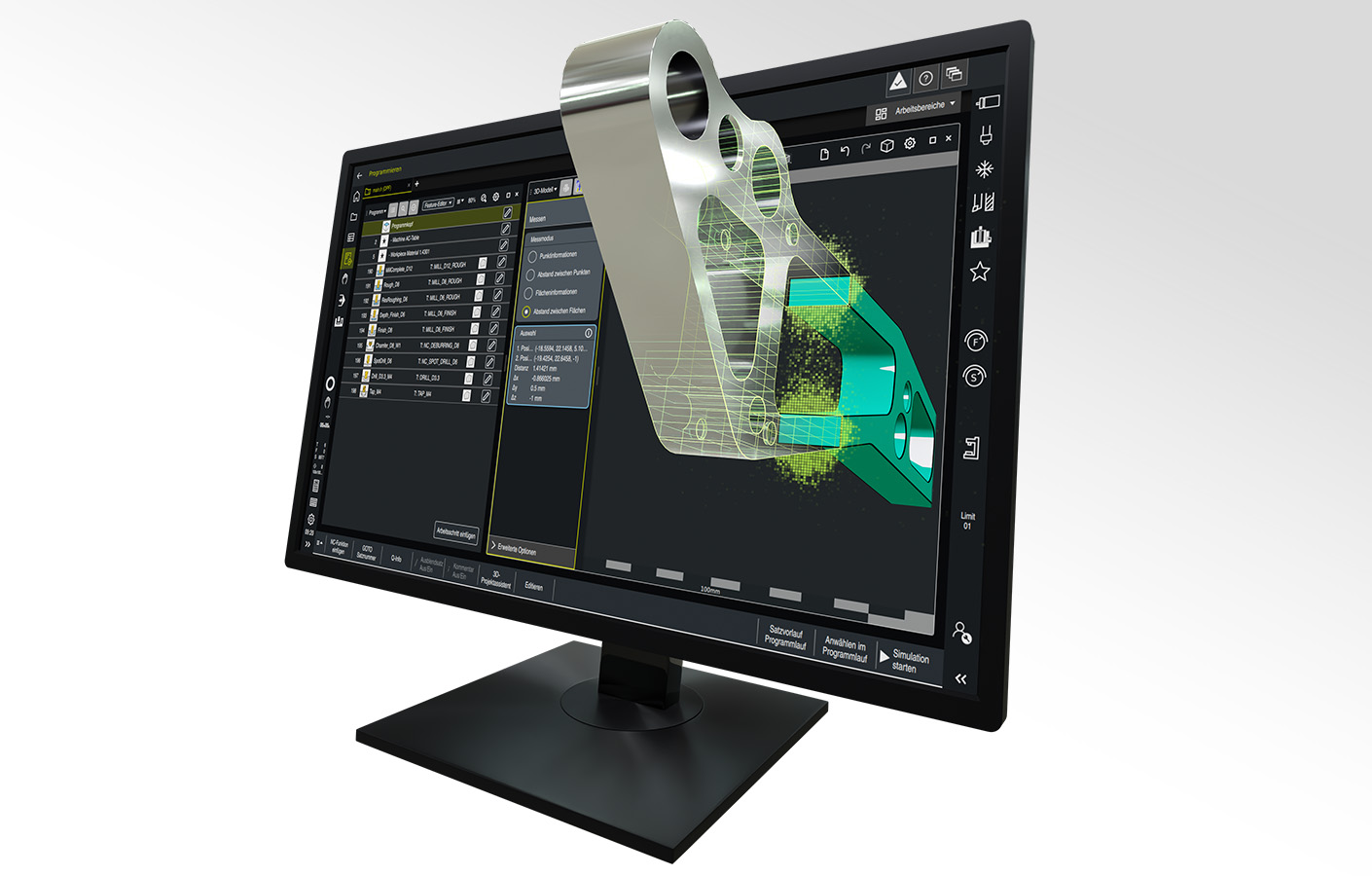

The next level of NC programming: With the vTNC7 programming system from HEIDENHAIN, workpiece designs can be transferred from the office to the machine in the workshop even faster.
This is exactly where the new vTNC7 software solution comes in. It enables machine operators to program 2.5D components quickly, reliably, and directly within their familiar operating environment, without having to rely on external systems. The result is a very powerful programming system, meaning that valuable shopfloor and process expertise can be put to immediate use, while additional programming capacity is created. The benefits are shorter lead times, reduced machine downtime, and noticeably greater efficiency, all while maintaining maximum flexibility and control.
FEATURE BASED PROGRAMMING
With Feature-Based Programming, the vTNC7 opens up a new dimension in NC programming. The programs are generated directly and intuitively from a component’s 3D model, making programming faster, more reliable, and easier to use. At the same time, the vTNC7 systematically captures valuable process and manufacturing
know-how. This information remains available for future use and can be incorporated into subsequent programs. The result is greater efficiency, increased standardization, and sustainable knowledge transfer throughout the organization.
