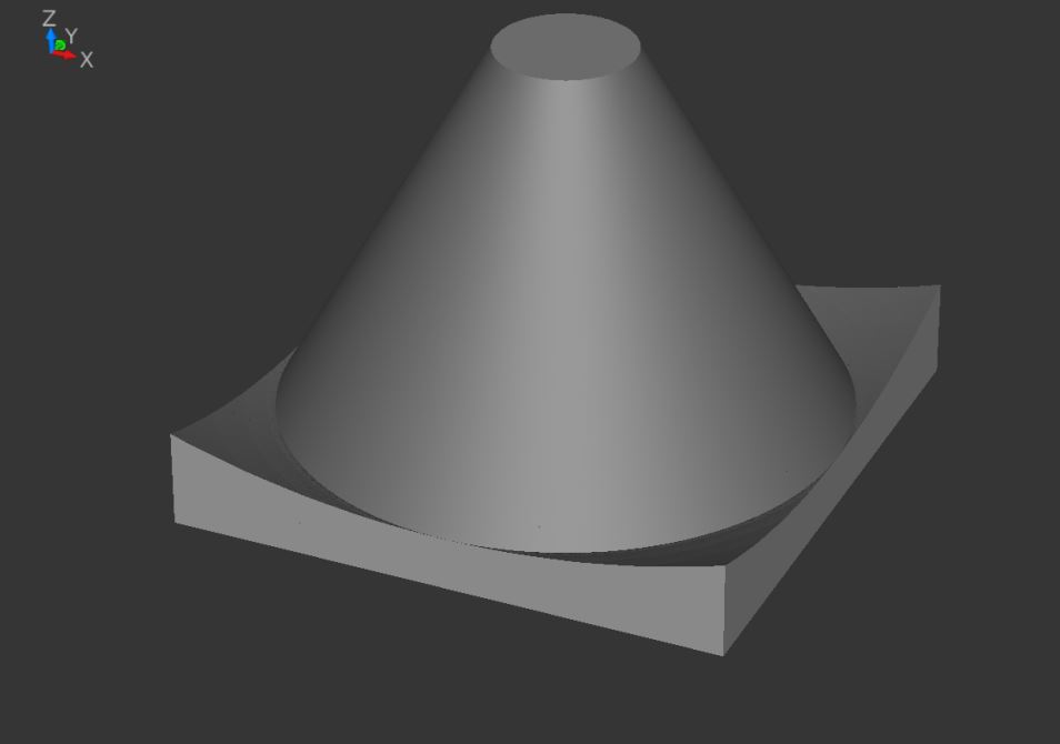

Create a taper by inclining the B axis and rotating the C axis
NC4035
NC program for creating a taper by inclining the B axis and rotating the C axis. The program is written for a machine with B swivel head and C rotary table. With the M128 function, the tool is moved along the programmed path, even if the workpiece is not clamped in the center of the C rotary table.
Remember the machine kinematics!
