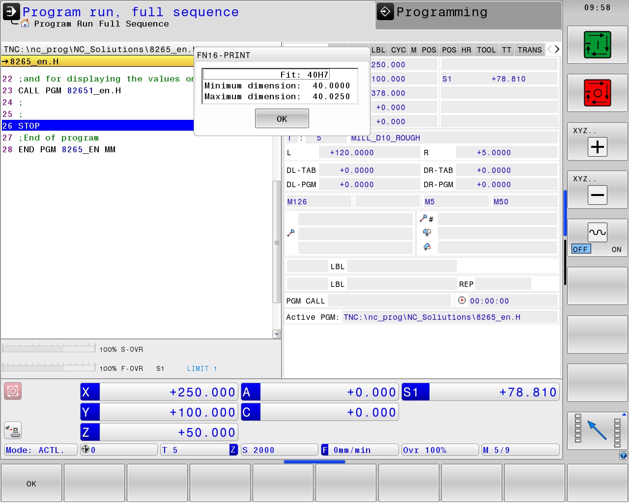

Displaying tolerances on the screen
NC8265
NC program for displaying the maximum dimension and the minimum dimension of a tolerance in compliance with ISO 286 on the screen.
For this purpose, the NC program uses freely defined tables in which the dimensions of the fits are defined.
TNC 640 TNC 620 TNC7 NC program Machine control Programming station Programming station VirtualBox Tables
