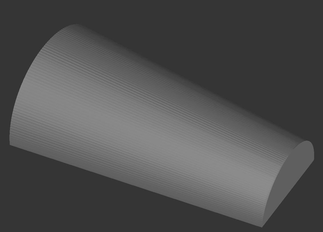

Horizontal truncated cone outside in contour lines
NC3040
NC-Program for machining a horizontal truncated cone from outside. The part is machined with a ball-nose cutter in contour lines whose number you define with the parameter SCALE (Q8).
The axis of rotation is parallel to the X axis.
														Milling
