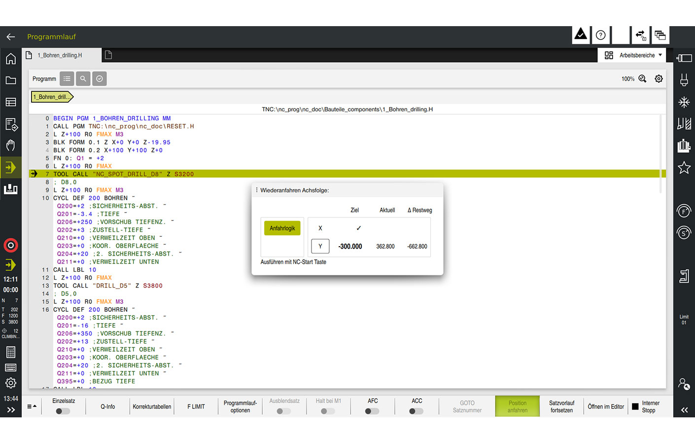

Modify the retraction direction at any time as well. Approach is also flexible with the TNC: With active 3D-ROT function simply select the appropriate axis sequence during the approach run, and change between manual and automatic traverse according to needs. Thus, in tilted systems, the TNC enables users to be in full control of all situations during approach and retraction.

Using the “mid-program startup” function (block scan) enables users to reliably start up in mid-program, for example following an internal stop. Select the mid-program startup function, and input the block number where the TNC should continue the machining run. The control then simulates the program run until the start-up position, loads all requisite process data and checks whether the correct tool is in the spindle. Pre-positioning is started with the “approach position” soft key. If needed, the TNC inserts the required tool.Always use the mid-program startup as the situation requires:
Interrupt the approach routine at any time and modify the approach sequence of the axes to adapt the approach direction. This functions both in tilted and untilted condition, and can also be combined with manual approach motions, which is handy when the work space is tight, especially with tilted machining. Take note of the following tip before you start: Make sure the start position is approached from the right direction. For this purpose the control must have implemented the position and status before the entered block. Unnecessary tool changes are avoided in the mid-program startup, by the way, when you enter the subsequent block number at which actual machining should begin instead of the number of a TOOL CALL.
Automatically or manually specifying the axis sequence for positioning
